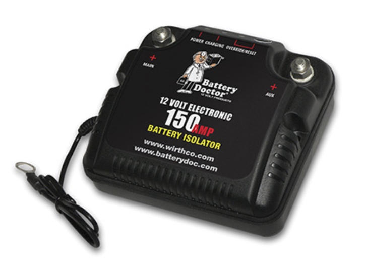

Anybody install be of these yet? If so, like it? Don't like it? Work well? POS? Seems like a fair alternative to the Nemesis Dual Battery Kit. About $200 for an M.O.R.E dual battery tray and this isolator. About half of the Nemesis kit, even after buying wires and terminals. http://www.wirthco.com/battery-isola...-601-l-en.html

Not to judge a book by its cover... but I usually stay away from items that have funny picture slogans on them and website links advertising themselves. I know its not fair as the quality on the inside could be pretty good and the inside is what counts.

Well if all you are getting for that $80 is the isolator, you could probably pick up a tried and true Cole Hersey Smart Isolator for almost the same price in the US. I have been running one for a number of years now and it continues to work just fine. That and the tray are really all you get with a Dual Battery setup. Maybe a couple of pre made cables, which you can do yourself. I appreciate that no one wants to spend the seemingly high cost of a simple tray and isolator, but when you see how tight the tolerances are to fit two batteries into that space, and have them safe and solid, you gain an appreciation for the effort that goes into designing and building that tray. Or at least I did. If a guy could get his hands on a manufactured one, you likely could replicate it, and perhaps even improve on the design, for a one unit build. I remember how expensive the Benchmark was for my '09, and thought it was outrages, until I installed it, The quality was there, and obviously the research and development that went into it must have been fairly extensive. Since it has held up extremely well, I believe I got my money's worth from it. It was also a pretty intense install with all that had to be removed, and the cutting of the factory battery/fuse box/air box tray.

the difference between the Cole Hersey and this unit is this unit works more like the alternative Genesis Off Road Kit. This unit has an over ride for putting the batteries in parallel. That little piece alone makes life easy when out on the trail and need a jump with no one around. ![Smile](https://www.jk-forum.com/forums/images/smilies/smile.png)

My Cole Hersey has the same feature. It can be wired into the inside of the vehicle and just initiated with the push of a button. A momentary is all that is required as the bridge is automatically disengaged after one minute. Great for self boosting! I didn't think it was that much more than the price mentioned. The last time I looked it was about $100.
