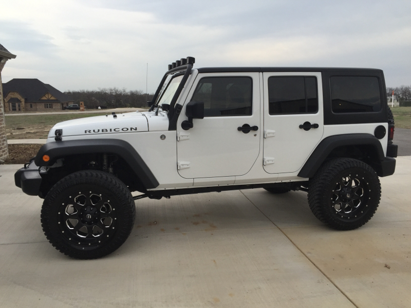

You need nothing. You may consider a wire wrap so as to not pinch wires while running them. I did it and it works well.
