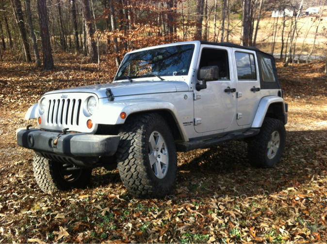

There are soo many options for you all depending on your budget. You can get a 2.5" spacer lift for a couple hundred or a 3" LIFT for over a thousand. All depends on what you wanna do with the jeep and the money you wanna spend. And yes, you can fit 35" tires on your 18" rims. You will either need flat fender flares or a lift and wheel spacers will be a must until you buy aftermarket wheels with better backspacing.

33x10.5 is as big as you are wanting to go with stock wheels. If u go bigger, u will need a different wheel with ~4" back spacing to handle 35x12.5. Also at least a 2.5" lift which are pretty reasonable. Also if u want to go to 35"s in future- consider at bare minimum 4.10 maybe even go 5.13. Especially if u have an automatic. I have 4.10 with an automatic in my Sahara and its a lil sluggish but manageable.
They're are plenty of guys running 35s on stock wheels, spacers will be a must. 2-3" of lift will be perfect, I would go with a minimum 4:10 gear ratio though, 3:73 will still feel really sluggish.
