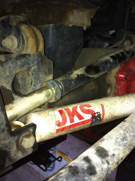

Just arrived at shop. Wife says the jeep "feels loose underneath". She said she got out and inspected the tires to see if one of the tires was comming off as we just had the 33's put back on but said the wheels looked fine. We've had a ton of snow lately and the roads are like washboards. I'm thinking the trac bar loosened or the Ball joints are toast. But what do I know. I'll update soon.

Ok. The ball joints are tight. The trac bar is torqued to 125 ftlbs on both ends but the jam nut was backed off? There was a bit of play at the point where the jam nut should be tight.

Looks to be loosened all the way. We just fixed our DW problem, ours was the the Track bar bolt hole in the frame was wallowed out and had to weld washers over it to make the hole round again.

Sorry. I took the pic just as my tech loosened it a couple more threads. But he loosened it with his fingers so yeah it was not tight. So he put some blue lock tite on it and tightened it up.
All I can figure is it worked itself loose on our horrible roads here. This town does snow removal a few days after a snow storm in the middle of the night using big cats and other heavy machinery. So while the snow sits on the ground it packs down and gets bumpy like a gravel road.
After he did this I test drove it but because of the roads I was only able to get up to 70kmhr but no dw.
So hopefully problem solved and I'll keep and eye on the jam nut.
