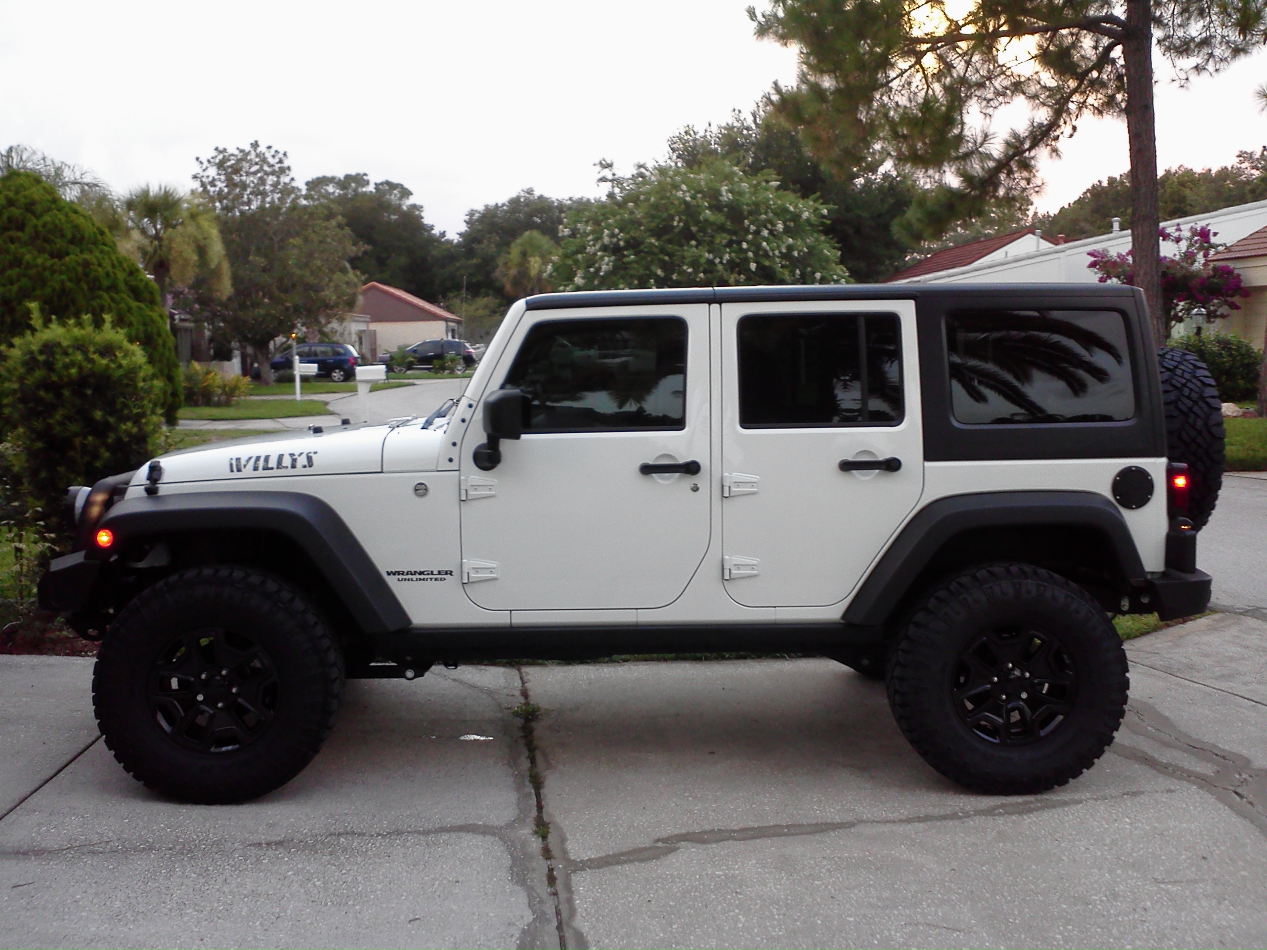

I installed the AEV 2.5" DualSport XT Suspension with AEV Geometry Correction Front Control Arm Drop Brackets and Spidertrax Black 1.5” Spacers with Factory Willys Wheeler 17” Wheels and Goodyear Wrangler DuraTrac 315/70/R17 Tires. No problem with the wheel spacers and purchased the tires from Discount Tires and they retorque my spacers and mounted tires with no questions. Make sure you buy quality wheel spacers like Spidertrax or Alloy and torque per instructions and use Red Loctite.
