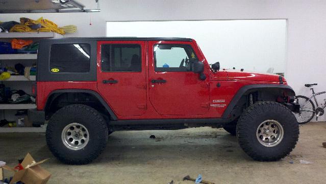

Well even with pinch seams beat in and rails cut you will not be able to run 37s with no lift you might me able to get away with the Tf leveling kit but no way stock. Here's mine with all the stuff you did plus 2.5" lift.

Proper back spacing on wheels and pushing the rear axle back in conjunction with the pinch weld rail mod got me there. That and some bumper mods.
I am also running stock bump stops and have some control arm contact up front at full lock. They would hit with 35s as well, more of a backspace thing.
The tires suck up nice into the fenders and I don't have any metal to rubber contact, crept for the front LCA.
Wound I call this setup a great rock crawling setup, no. Good overall with the type of off roading I have been up to as of late.
I spent many hours flexing, twisting, and checking overall clearance issues.
