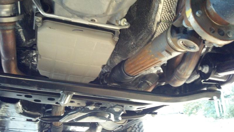

I used some washers on my 2012 and teraflex exhaust spacers. No rubbing at all but drive shaft is at max angle just driving they tilted the engine and tranny so much. I need a new shaft but its working for now till next month when i get a shaft. What year do you have If you have a 07-11 you will be fine if its a standard just shim the skid down a little bit. I had the same problem on my 2009 but i had a auto and it hit the tranny skid and ripped my boot i traded it in so never bought a new shaft.
