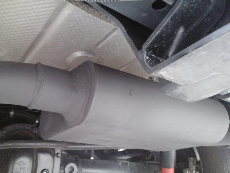

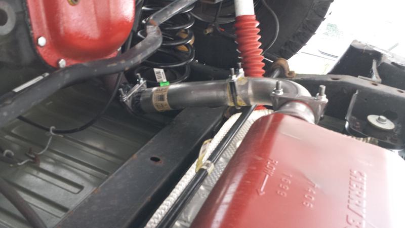

Cherry bomb pro series 2.5inch in/out. Cost 57 bucks at pep boys.
One can of high heat red spray paint
4 universal exhaust clamps
2 universal muffler hangers with a little custom fit
A couple of adapters from summit racing

Pictures aren't the greatest. But you get the point.
I went with the pro model because supposedly the internal design is made to cancel out the higher frequency exhaust tones while keep the low tone ones. I didn't want that ricey sound of a Honda civic. To my amazement its sound so good. No gargling or raspy sounds. I just have a simple down turn tail clamped on for now.
Im glad to get that stock pos off. That thing ways a ton too!

I have the Rusty's exhaust which uses the cherry bomb pro...about 2 years now and I'm pleased. Looks good and you save a few bucks too...the Rusty's axle back is around $160 which is still a deal if you ask me.

And and a word of advice . Just cut old muffler off with saw saw. And rubber hangers too. Impossible to get off

Looks really good, how's the clearance compared to stock?

The clearance is definitely up higher because the actually muffler size is smaller than stock. But I guess the ultimate clearance save would be to dump the muffler out b4 axle
