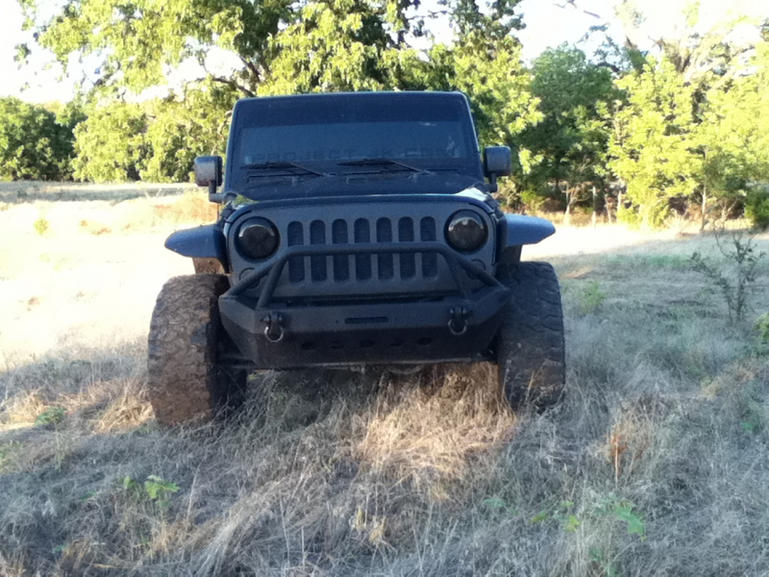

Mine stick out about 1.5 inches with 33/12.5s with 16x9 wheels with 4.5 inches if backspacing...
