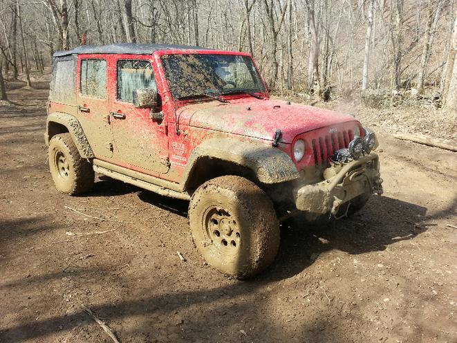

I got mine last July and it looks brand new (except for the mud ). Pulled several large vehicles with my winch and the bumper handled it no problem. I highly recommend the bumper. FYI... I bought my from Chris at JeepAdOns.
