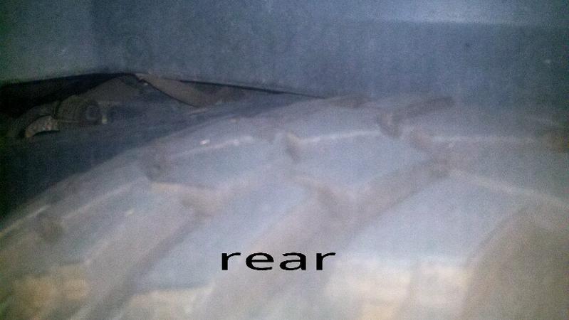

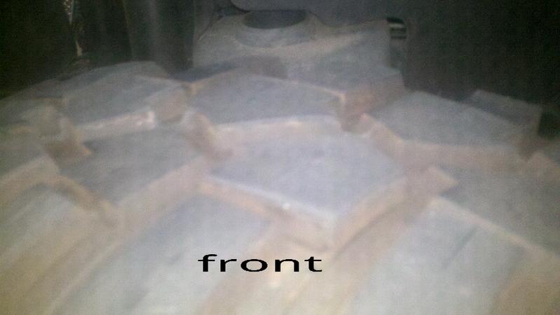

Need some advice...I just noticed that my front tires are wearing in an odd way. I have 32" mud terrain tires with no suspension modifications. If I move my hand across the lugs of the rear tires they are evenly wearing and are flat across all lugs. On the front tires, if I move my hand across the lugs it feels bumpy and you can see how the lugs are different heights. Both front tires have similar wear patterns. Any ideas?

If they are wear more on the inside or outside treadlines then it is a toe problem. if they are wear more in the middle it is a air pressure problem. I would start with the obvious and check the pressure all the way around and go from there.
I agree. It could be an alignment issue but it may be bad shocks or maybe you just need to rotate the tires more often. How many miles do you rotate them? Since you say it's only the front, that would make you assume that this developed since your last rotation.

Uneven tread wear like you described is a shock problem.
