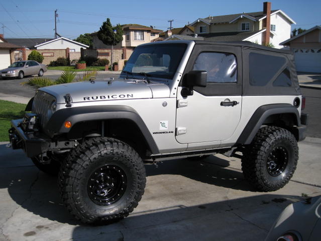

I just got mine a couple weeks ago. They are on 15x8 with 3.75 back space and they fit just fine. At full turn left and right it doesnt rub with my setup. Havent been offroad yet to see if will rub when flexed.

that looks great man! my wheels have 4" BS so i need to go ahead and get the grinder out i didn't understand that 3.75" BS is the way to go until like 20 minutes after i ordered
