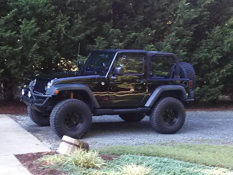

I got the OME kit from Northridge that come with the JKS F/R TB's. Awsome ride! I would like add that if you get the OME kit, get the OME long travel shocks over standard, brake line drop brackets or new longer lines and front lower control arms over drop brackets and you are set to go.
I helped a friend install Bilstein shocks, and what a pain in the getting that allen key on top of the front shocks.
Cleaned up poser shot.
