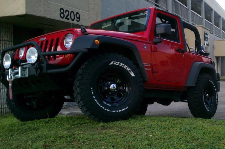

my tire place put 60 psi on my Fierce attitude new tires they are 285/75r16. is my first big tires... is this correct ?? i thought they should have 35 psi like the door said.. please advice ?
the car is align and drives perfect. but i was wondering about tire uneven wear in the future.
the pic just because i love how it looks (time to go mudding this weekend !!)

60 pounds is way to much. You would be safe with 35 to 37. On the trail you would be comfortable airing down to 15 as well. Comes down to personal preference and how you want the ride to be.
On a side note, those new tires are looking pretty slick!
