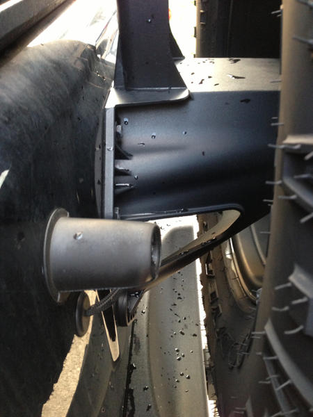

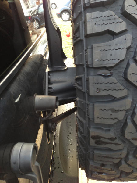

I have been running my new gy duratrac 35" tire with my stock spare tire setup for 2 1/2 months now. I installed the MBRP spare tire reinforcement with smittybilt adjustable mount and it has yet to show any problems. I was just wondering if anyone had pics or a story about why this is not ok.
The reinforcing brackets help a lot my story is i have toyo mt 285/75/17 which is a 34 inch tire. tire alone weighs 97 pounds on stock rims on my gate quite a little bit of time the only thing it cause on mine it made the hinges lose at the pins.just keep an eye on it. I just installed the teraflex carrier now i do not have to worry about it. Good luck
