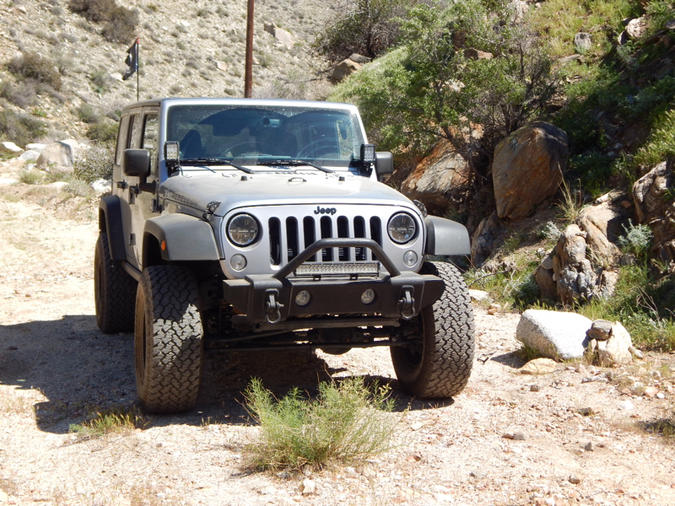

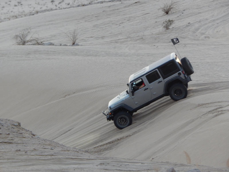

I got the terraflex 3 inch with all 8 and could not be happier. I also got the terraflex trackbar. Did lots of research and this was the kit for me. Feels good onroad and and does great offroad too. <img src="https://www.jk-forum.com/forums/attachment.php?attachmentid=602841"/> <img src="https://www.jk-forum.com/forums/attachment.php?attachmentid=602842"/>

Looks like factory with some d ring mounts
