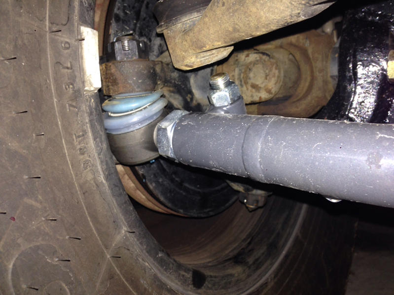

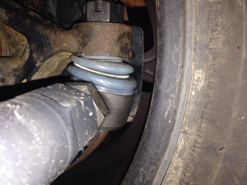

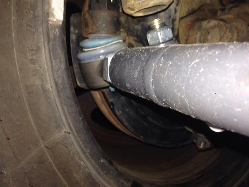

Not as much as i first thought. But still a good inch of space. Pro comp 16x8 4.5bs
Old 03-16-2014, 01:00 AM
Mark Doiron's Avatar
Join Date: Mar 2007
Location: Midwest City, OK
Posts: 14,790
Received 362 Likes on 270 Posts
Not sure if this applies to the Synergy tie rod, but with the Currie tie rod and 16" wheels with 4.5" BS it is very close. So close that it scrapes off wheel balance weights off if they are placed right at the inner edge, so I ensure the mechanic puts them further outboard on the wheels.
