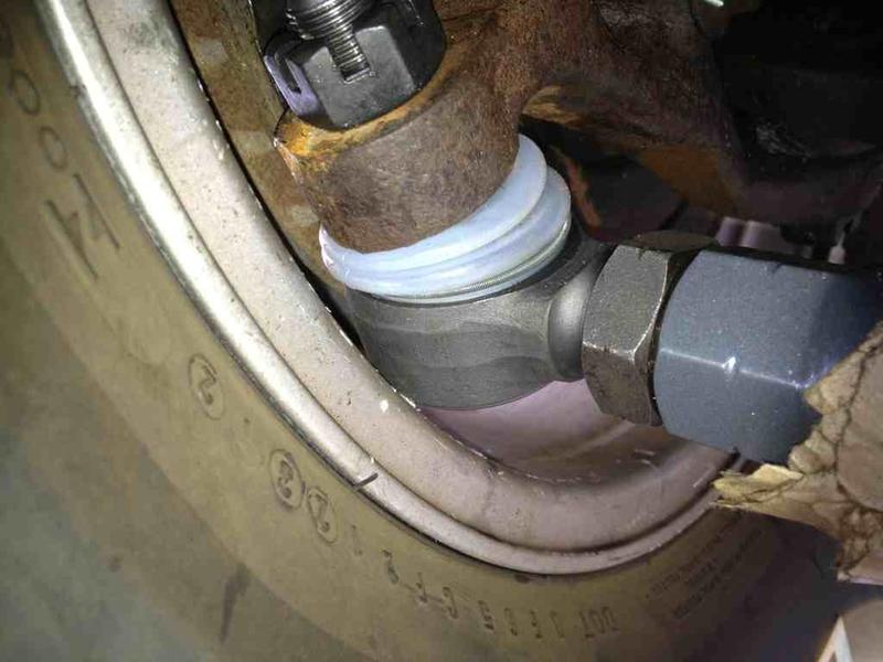

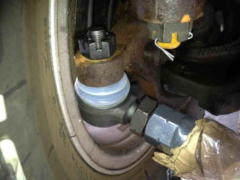

I figure I post on here and see if anybody has or is running this setup.
The 1 ton tie rod ends synergy uses are massive and won't fit my 15. I already have a plan of attack and will post if it works out.
I was hopping somebody has this setup with a different wheel. I am running Black rock vipers 3.75 BS.
RK I believe used OEM ends (TRE at pitman) or a MOOG end. The site says
Their TR won't work with 15's although I know some folks that do and have no problem. Synergy only requires 4.5 or less BS.
What I did was find a moog joint that is similar is size. Identical thread (TPI) shank size and taper. Also both joints are left hand thread. I found Moog ES452L
The joints will be here Saturday. Plan B is new wheels with a little more room inside.
Ken

We have this tierod on our rig with the 15x8 Cragar Soft 8's. We have 4" of back spacing and don't have any issues.
