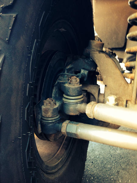

At least one side needs to be completely drooped down so the drag link keeps it's orientation. I'll post some pics in a bit to show you what I mean

In the second pic you can see how the joint is maxed out downwards due to the weight and outward bend of the draglink. In order to get the bar oriented right that joint or the other has to be maxed out. Now that the bar is in it's proper orientation you can get the other joint to sit level as shown in the first pic
