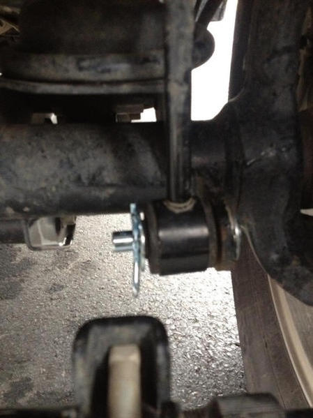

I bought the rough country disconnects for $50. Definitely the best price for these. I started out with the $5 grade 8 hardware but wasn't a long term solution. The rough country doesn't require grease, so definitely check them out.
Just curious, why not a long term solution?
