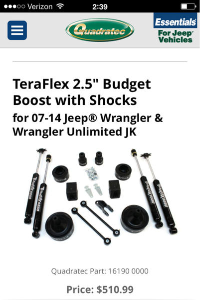

I would look at "Budget Boosts." Here are a couple of examples. There are quite a few of these types of kits. Check out Northridge4x4, Qudratec, Rebel Off Road. Hope this helps you out. If youre staying with stock axles it would probably be wise to go no bigger than a 35" tire. (Thats debatable, but the bigger the heavier and more expensive) I went with a 3.5" Rock Krawler X Factor lift. Couldnt be happier with it. I cant remember, but I think if you go over 3"s of lift you will want to replace your front drive shaft. (Please correct me if Im wrong)

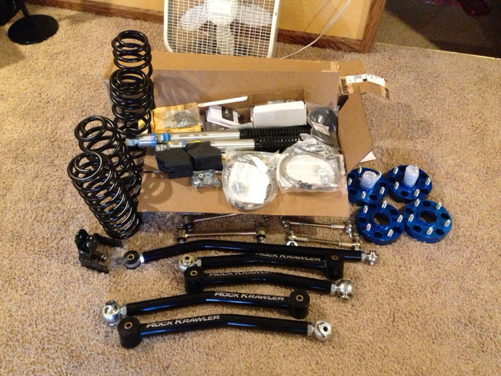

I think for the money the RK 2.5 max travel lift you get from Northridge is one of the most complete lift for the price. You get lower control arms, springs, shocks, extended brake lines, bump stops, track bar, and quick disconnect end links. I got the lift, wheel spacers, and exhaust spacers for $1,680. For everything you get really hard to beat that price.

Holy crap! That kit wasnt available when I got mine from NR4x4.. Thats frikin awesome! That is a hard deal to beat right there! Thanks for pointing that one out. I was trying to help a friend find a kit and I think he would be good with that one. Now if I could find a good set of 35"s that wont break the bank. I went with Treadwright because of value. Granted I love the tires and they do great everywhere, they dont let you air down because it voids the warranty. Any help here? I thought I was good at finding deals, but damn thats a good one you found there! Not even my thread, but thanks for the help dude!!!
