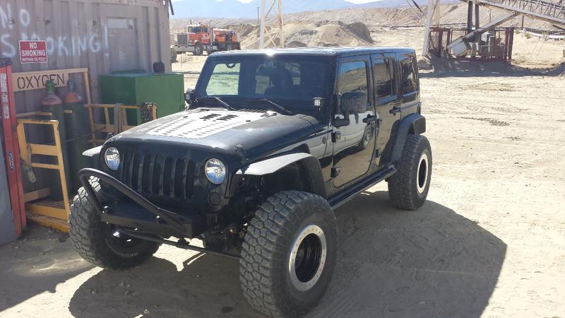

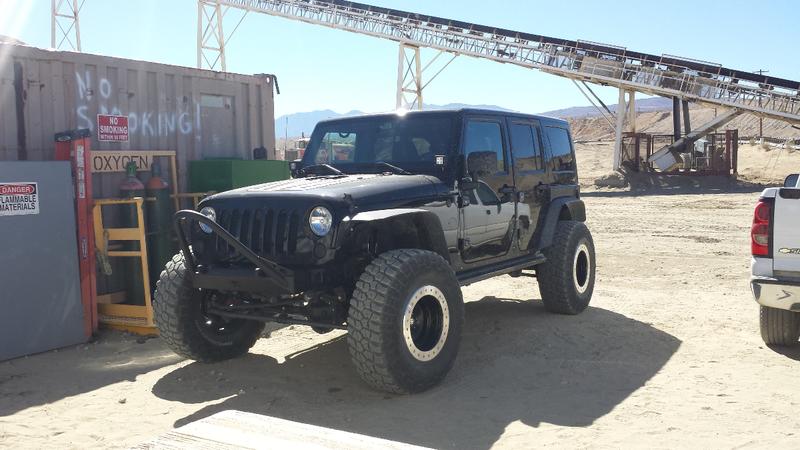

Yep. Here's my rig with a Rock Krawler 2.5 lift, trimmed factory fenders and 37's.
Attachment 500805
Attachment 500805
