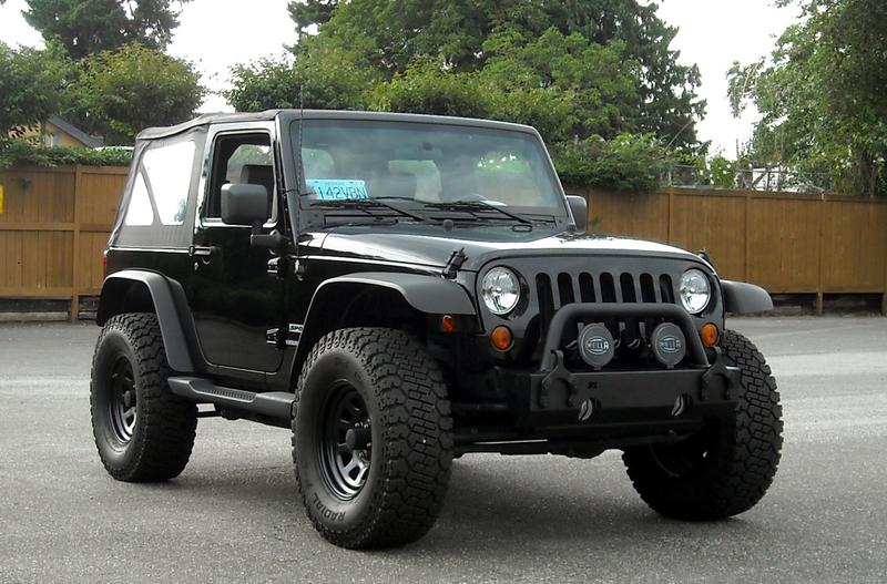

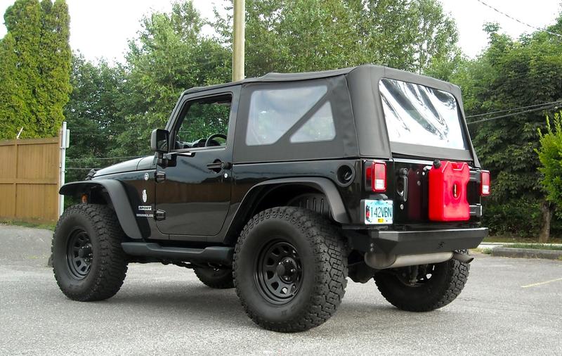

I gave up my 3" Teraflex lift kit for stock suspension (with front 0.75" Daystar spacers for leveling) and Rugged Ridge flat fender flares... still fits my 35s with enough room for flexing AND the ride is actually smoother.
