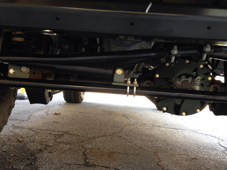

I bought mine for 2013 Jeep JK. I have no idea if the instructions are any different for the 07-11, but I doubt it. It says in mine that "and if using the factory stabilizer reuse the factory hardware".
But to answer your question about pressing out the sleeve. Yes, it can be done without damaging it.
![](http://i34.photobucket.com/albums/d105/mhockey9090/Jeep%202013%20wrangler/905E488E-FFBD-4F78-9D47-20801D6B619D_zpsglz4xvuh.jpg)
