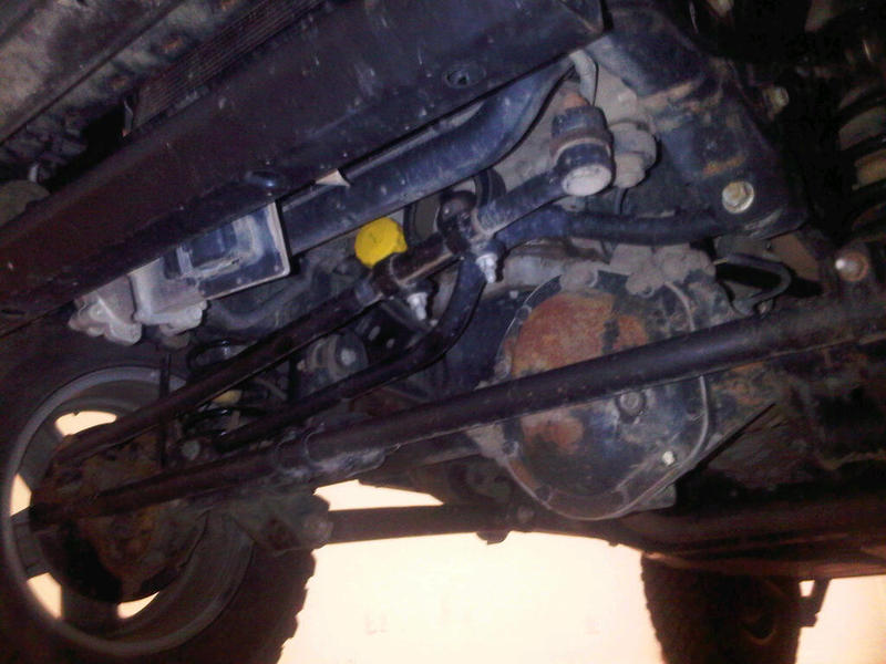

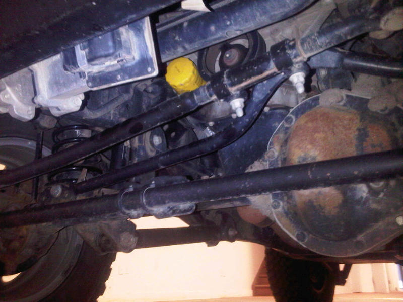

Flighty Handling - the stock caster is a bit over 4 degrees. As you lift higher, that number goes lower, which causes the steering to be 'flightier'. An alignment shop can not fix this. You would need some form of caster correction - (cam bolts, new longer/shorter 'fixed' arms, control arm brackets, adjustable control arms). At your lift height, this may be wanted, but is not 'needed'.
Bump Steer - As you lift higher, the angles on your steering components will get tweaked. Generally, you want the trackbar and draglink to be parallel, and as level as possible. (drop pitman w/ tracbar relo bracket, or a flip kit). At your lift height, this really should not be an issue. Unless you have a bracket but no pitman, or a pitman with no bracket?

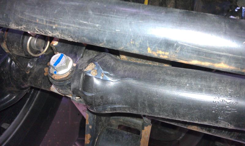

I've attached pictures to show the angle you were talking about.
