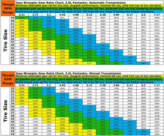

Sounds like your building a dedicated trail rig... that's not a bad thing, but 37's on a DD and will be at 80MPH sounds like a gas hog to me, which is what you don't want. You WILL need to Re-gear the Diff's for 35's to maintain a decent gas mileage, you should probably invest in sleeves and a Truss for the front Diff and eventually axles too. Everything else look right on parity what your wanting to do with the jeep. If I were you I'd look into buying a truck and trailer to haul the jeep, it's more practical if you guys are going to be going to different events around the county. Nothing worst then breaking something and being stranded, waiting for a fix from a local shop or dealership.
I just recently went from 33's to 35's, still on stock gears (3.73) and I went from 15MPG to 12MPH lol. The jeep struggles to do 80 so I keep her at 70 on the Hwy to avoid over heating the transmission. I'm also running an external Transmission cooler with a 8" slim fan to keep the transmission from over heating on the trails. It's really sluggish when taking off from a stop, I will be ordering my gears at the 1st of the month (5.13) this will get rid of the sluggish feel and help on the Hwy. I drive my jeep about 150 miles a week so it's not a big deal but the wife hates driving it because it's "slow"... Duh is a brick on wheels
These are the things I needed to hear and consider. Regarding us towing to events, that was the exact plan to be executed in the next couple of years. The hope is we'll get a motor-home and put this on a trailer, I'm beginning to feel that maybe I should stay with 35's for now until we are ready to tow, and if this "Jeep thing" becomes all that we think and hope it will, then maybe get a little more aggressive with it. I'll read up some more on potential costs to do it all correctly the first time.
I won't rule out 37s yet, but I'm now leaning back towards 35s.
P.S. you runing the 3.8 or 3.6 motor?

Go ahead and price the heavier duty steering components, balljoints, the front housing gussets/sleeves/truss, alloy shafts, and the gears - just so you have an idea of the costs for if/when.
What backspacing are you considering?
