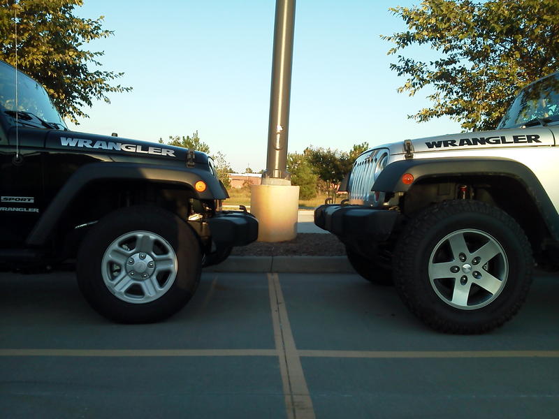

with 19/60 combo you'll see a significant boost over the 14/55. I replaced just the front 14s on mine to offset a winch/bumper and mine sit higher in the front now with the winch and bumper than it did without.
