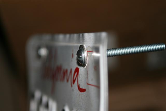

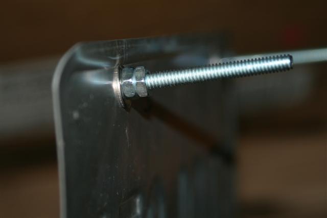

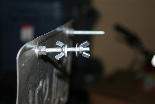

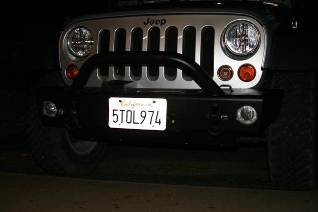

Below is my "for now" solution to the problem (Sorry for the need to click the pics, but I don't have any web photo galleries setup at the moment).
I used (2) 1/4" x 2.5" bolts, with (8) 1/4" washers, (4) 1/4" nuts, and (2) 1/4" wing nuts to mount the plate using the holes that were already drilled in the bumper.
Attached are pics that should be mostly self-explainatory regarding the install.
The regular nuts hold the plate on the tips of the bolts and the wing nuts sandwich the bolts on the bumper, so the plate is kept firmly at enough of a distance form the bumper to make room for the fairlead and wire hook (I'm not using the roller fairlead, so a longer bolt would be needed if that's what you're running, since it is much thicker).
I just did this yesterday, so I can't speak for how long this lasts at highway speeds, but so far it's working great!
