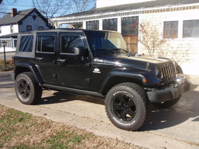

I would go with the 305/65/18" BFG All Terrain. Approximately 33.8" tall. I have them on the stock Sahara wheels(painted Black). You do need to run 1 1/2" spacers. I have the FT 2" BB. But I would go with the Teraflex 2.5" coil lift - which I am going to do when the $$$ is there.
