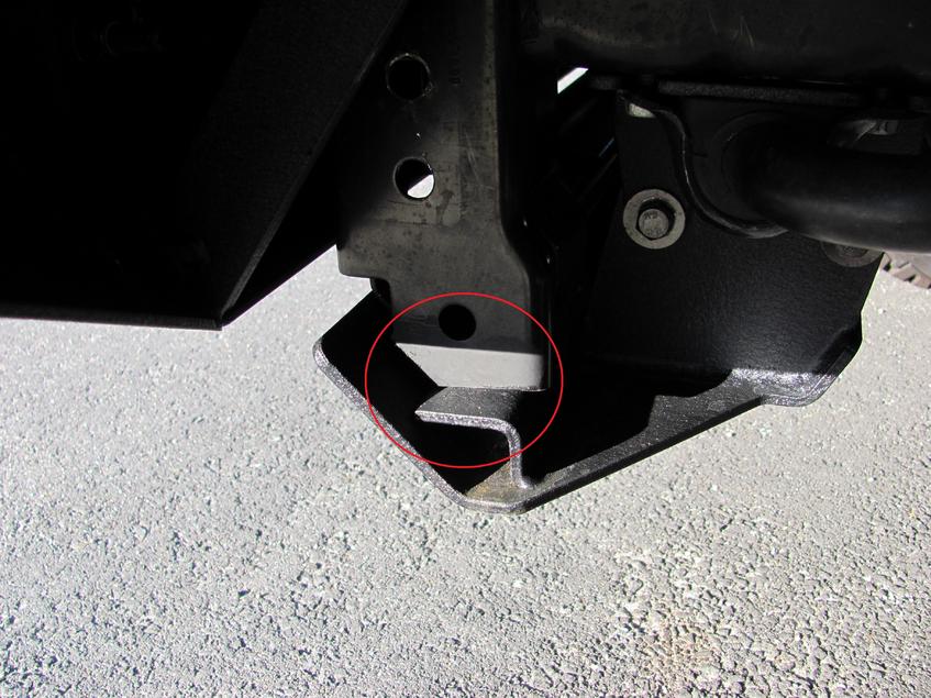

I just purchased a front bumper and skid plate from Rugged Ridge. It's a great bumper but everyone should be aware that the skid plate requires some trimming to the crossmember to fit on a 2010.
On the side of the front crossmember Jeep installed a plate and it hangs about 1/4" below the crossmember and won't let the skid plate sit flush which won't let you attach it to the mounting brackets
Just thought everyone thinking of buying this should know ahead what you need to do to make it fit.
The pic shows what I am talking about (in the red circle)

Hmm...I see that.....my 07 doesn't have that end plate and it fit great...that sucks.

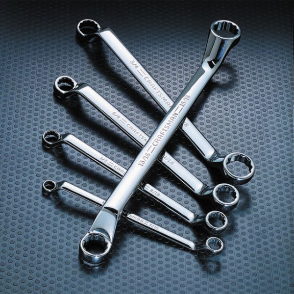

The trimming is not too bad....a cut off wheel works great but, after trimming the 1/4" inch off there is a little problem with getting a wrench in there to tighten the bolts to the crossmember.
What I did was after cutting the 1/4", I cut the front weld on that "cover" and trimmed a little more and had to use an offset box wrench(see pic) to hold onto the nut. It's not too hard, just took a little figuring out....still a fantastic skid plate and bumper.

We have updated the instructions regarding the 2010 change. We have also changed the hardware to include nut plates so that the bolts can be started without trying to get a wrench inside the cross-bar. At this time we are still trying to work throught the current inventory.. Should have 2010 corrected stock soon. We have also found that some models require you to drill one mounting hole.
Sorry for the issue... Sometimes these changes are made and you just don't know about it until they are already in the market. ..
