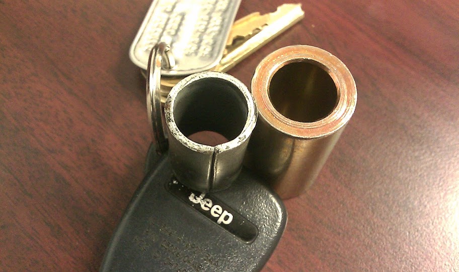

Here's an example...
Both the Rough Country Lift and my Rock Krawler lift came with crush sleeves to use on the rear track bar relocation brackets. Here's a photo of the difference between the two:
(The one on the left is RC, the one on the right is RK).
As you can see, there is definitely a difference in quality. Again, it's a personal decision as to whether the RC is "good enough" or whether the RK is "worth the cost". Alot of that depends on how you wheel.
