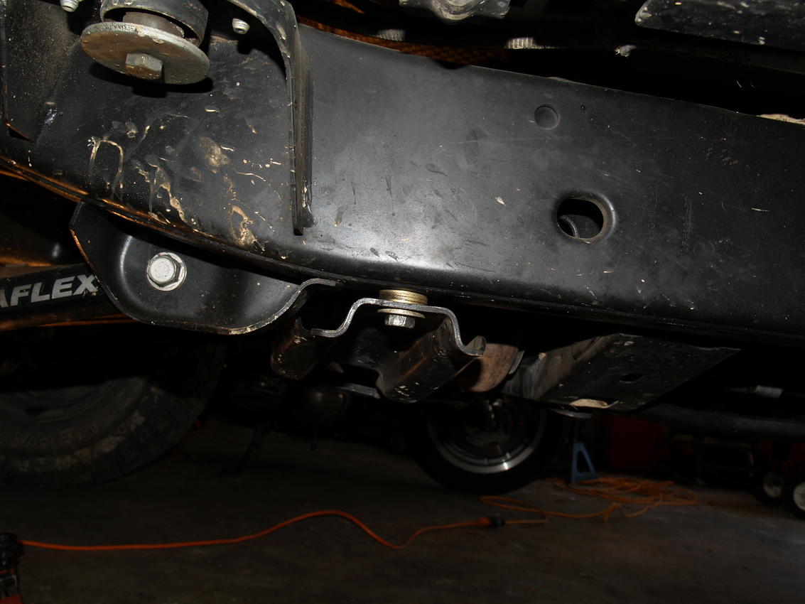

This is what I did and my front ds lasted a long time.
Cut off the band on the boot and replaced with a ziptie( the nub on the band will hit the tranny pan under articulation)
Notched the skid AND crossmember
Lowered the skid and crossmember using some washers.

This is no gaurantee that yours won't blow, but it kept me from having to get a new shaft for about a year, (several months on a BB, then a 4in lift) in fact I still have it and the cv joints are not torn and it doesn't seem to be bad. I only off-road once a month, if you go every weekend you'll probably need a front shaft sooner. When I put the 4in on I had an adj front trackbar and got the axle perfectly centered aswell, dunno if it helped keep from ripping the boot, but it didn't hurt.
