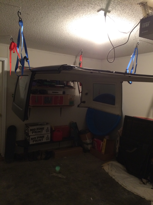

I use two ratchet straps and two pull straps connected to eye screws in the ceiling of my garage for my hard top. I'm sure a similar set up would work well for a roof rack as well.

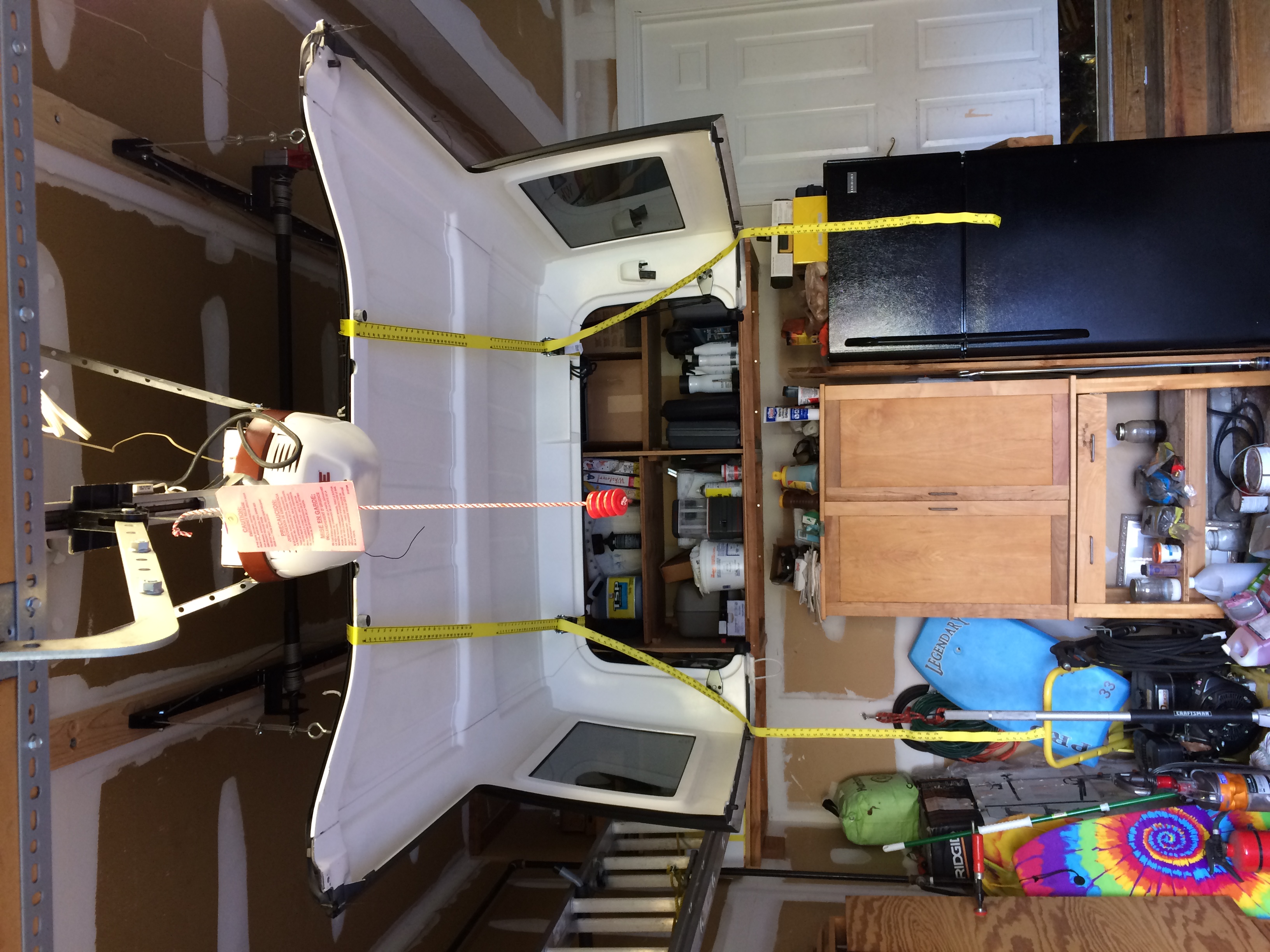

I installed the Racor lift a few weeks ago and couldn't be happier. I store the freedom panels on their bag on top of the lift and use ratchet straps to secure the top to the underside of the lift. Now removing and installing the top is a one man job (or 14 year old job yes so easy my son can do it). Sorry for the crazy angle of the photos, if someone knows how to edit attachments to rotate the picture please let me know.

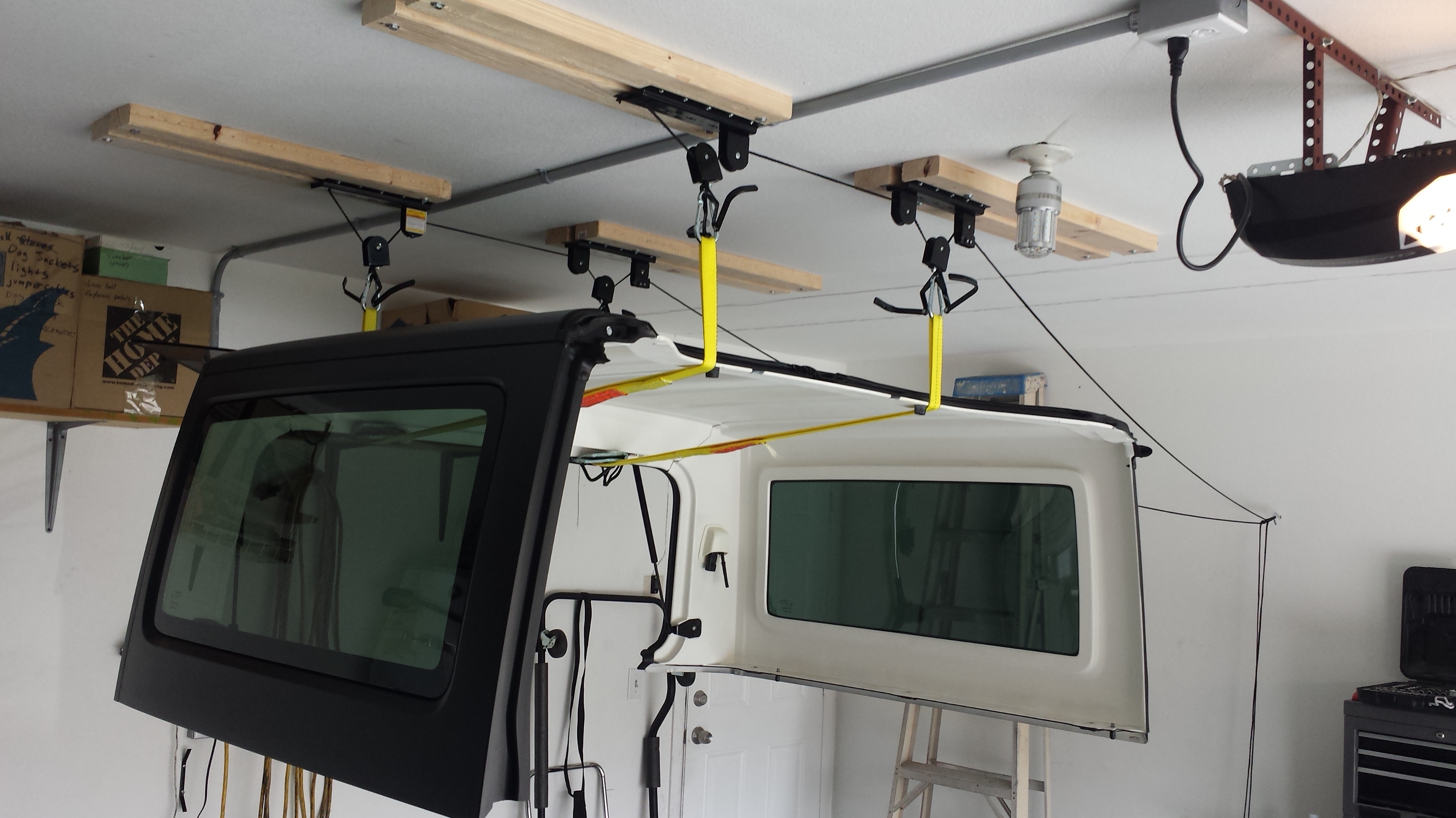

I made a hoist for my hardtop with 2 bike hoists from harbor freight. Bicycle Lift They're good for 50#s each.
