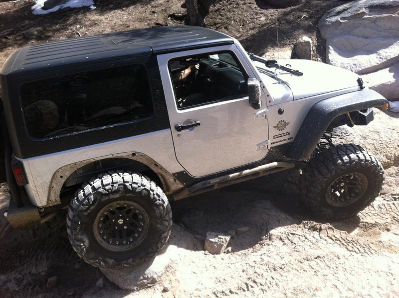

I recommend the ACE weld on sliders, that's what I run and wouldn't run anything but weld on. I know EVO makes some weld on sliders as well and that would be my second choice.
Here is a pic
