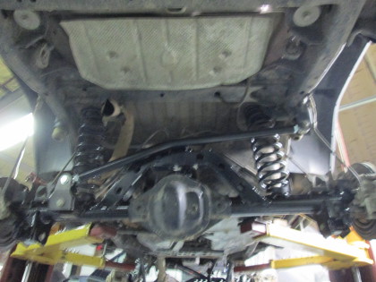

Set it up so that it bends slightly away from the axle just enough to clear the springs but also you want the tip of the bend pointing up.
It should look similar to this.

Typically they are slightly rolled to the rear of the vehicle! Give us a shout if you have any other questions.

It looks like it should hit it, but if it does I don't notice. If it does, the rubber exhaust hangers would just let it ride up and back down with no harm.
