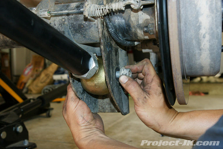

Name:	tf joint.jpg
Pic of a TF joint, notice its not cocked one way or another sideways.
