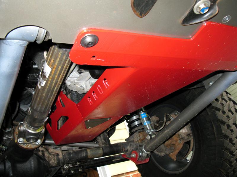

I did see where mine was touching the pan in same area. Do not have that problem now. I heavily modified the trans skid to work with the FT cross member that came with my long arm kit. Project involved trimming about 1 1/2 inches off back end, then notching corner to clear factory brace on driver side. Also had to bend rear tab to make flush with FT cross brace. Finally I used a BFH to bend the bracket where the connecting bolt attaches the oil pan and trans pan skids.
(Actually TINMAN080 did most of the cutting, bending and welding. Thanks!)
Then I drilled two new holes at rear to attach to FT cross brace.
The FT cross brace is about 3" lower than the factory cross member, which moved my trans skid well away from the transmission oil pan. No more clearance issues.
A couple pictures show where I ground added clearance for the two lines. Probably could have taken more off though because lines are still very close to skid.
