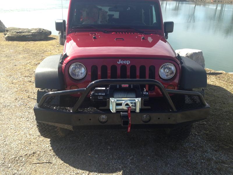

This is the Ranch Hand bumper,keep in mind not all type winchs are compaitable with low profile bumpers case in point with mine I had to do the deck mount or top mount because the motor on the side of the Warn 9.5cti either didn't fit or set offset in the low profile bumpers ,I learned my lesson on buying winch first
