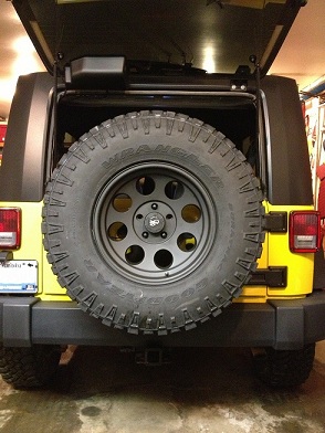

Well I got my 315/70/17 GY Duratrac's mounted on ProComp 7069's and went to install the rear tire and I'm having problems. I got the MBRP spare re-enforcement kit and the MBRP tire relocate bracket and installed both. The re-enforcement kit went on super easy, I had read of people having problems snapping the supplied bolts but I managed to break off all the welded nuts with one bolt. Whole process took no more then 30 minutes. I found if you thread the bolt in a little more then 1/4" and just wiggled with a pair of vice grips it snapped off, the instructions say they snap easy I wouldn't say easy but it's not terribly difficult. You just gotta work them around a bit. The hard part is getting your hands in the vent hole to line up the brackets. Anyways after the kit was installed I added the Daystar extended bump stops and tried to mount the spare and this is where my headache started. The tire does not even come close to touching the bump stop. It's out by a good inch. I decided I would ditch the relocate bracket and just mount it on the stock mount. Well it would have worked out perfectly but now the tire hits on the bumper and won't mount up square and it also restricts the movement of the rear gate. Also as you can see in the picture my third brake light is not visible anymore. So now I am wondering if anyone else has had this problem and how you went about fixing it. I thought maybe I could get a 1-1.5" wheel spacer and mount it on the carrier and hopefully it would clear the bumper and also make the brake light visible again. Anyways if anyone else has had a similar problem or has a suggestion I'd greatly appreciate hearing them!!

I have a 35x12.50 nitto trail grappler on my stock spare carrier. All I used was a 1 1/2" wheel spacer mounted on the carrier and my light is visible. Not the strongest setup but it works for now or until it starts to break
It's pretty clear that with a bigger tire , you won't see the 3rd brake light anymore with the stock brake light . Some companies do make a 3rd brake light extension . I mounted by bigger spare on the stock carrier without reinforcement and bent my tail gate . Now I have a Hanson rear bumper and tire carrier with the same exact bumpstops you have and they fit perfectly .I would not trust the stock carrier even with the reinforcement as my tail gate bent at the hinge , not the carrier itself .I don't know why your tire doesn't lay against the new bump stops . Good luck !

It's not that clear... There are several guys on here who have a 35 mounted and still can see their 3rd brake light without an extension. Also the GY Duratrac is one of the lightest tires in this size (60lbs). I will eventually go to a rear bumper and carrier but for the time being I am pretty satisified with this setup if only it would snug up a little better. Thanks though.
Meh I hate "band-aid" fixes. I think I will try a wheel spacer before I try to MacGyver things... It's not proper and I hate to try and rig up a fix that "works" rather make it work. I'm gonna go bigger so may as well get a proper carrier just figured that others that have went 35" before have had similar experiences. Guess not..
I will get a tire carrier/bumper one day but this was the cheapest way to go at the time. I haven't had any trouble with the gate either. I've had mine on almost a year(10,000 miles) and I open and close the rear gate a half dozen times or more a day.
