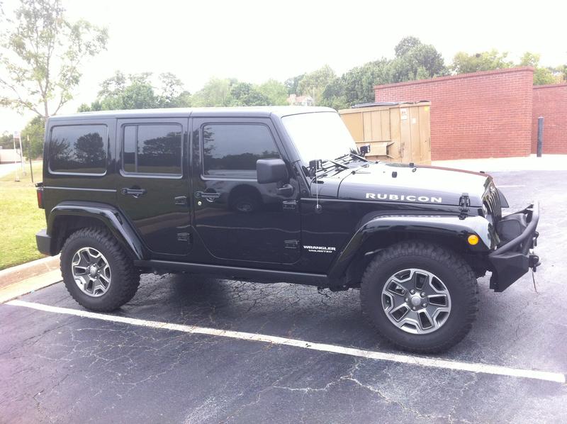

After installing a winch and bumper on my 2013 JKUR and seeing how much it sagged the front end I decided to install a 2" Daystar leveling kit. Now, I've decided to install a rear bumper with tire carrier. Like the front, I assume the weight of the rear bumper will cause the rear to sag. I looked online and it looks like 1" Teraflex coil spacers will run me $80 for the pair, but Synergy brand spacers are only $50 a pair. Any any benefit to Teraflex over Synergy?
Anyone know where I could get either brand (or another brand) spacer for cheaper than what I've found?
Here is how she sits today:
