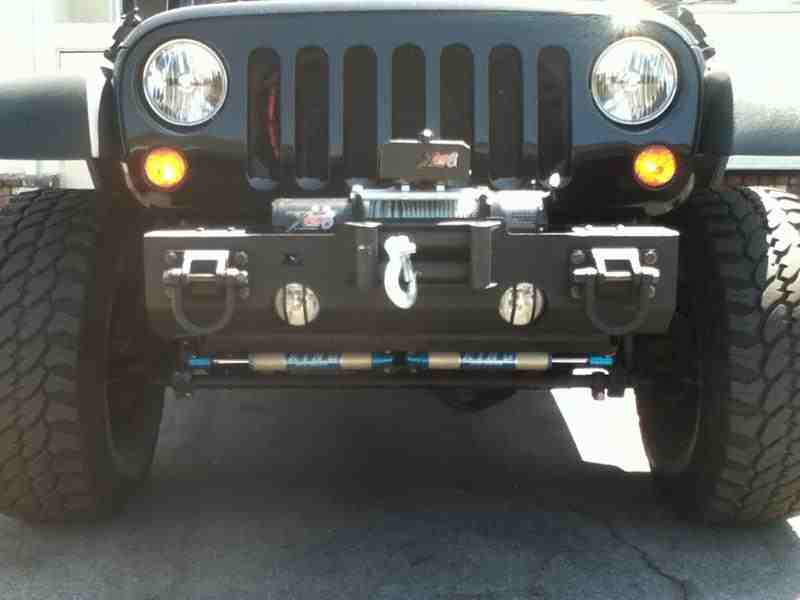

Originally Posted by DONKEY-PUNCH
Unless Jeeps are now flying through asteroid fields, a dual stabilizer will NOT bite onto anything, as its attached above the tie rod. I have non of these issues, yet I run them and makes it hell of a lot more controllable Off-road.

Donkey-Punch,
IDK man, during my interstellar Jeep travels, I have had a heck of a time with the asteroid fields! LOL! Your setup is nice and protected so, not a concern for you but, I have seen some kits where they mount the stabilizers at the same level as the the tie-rod, directly in front of it. (that's asking to get hit!) After searching for a while, I found a pic of the kit the OP posted installed and it appears they are above the tie-rod so that is good. Still wholly unnecessary with 33's though!!!
Yours is a well thought out design. (and I would assume specially valved) I am just so used to seeing rigged up junk out this way that it makes for a predisposition against the multiple setup! IDK about Cali but, here in the south we see a good bit of the oh, just slap a few more stabilizers on it, it'll work mindset! I've seen rigs with 4 of them, all with springs on them (kinda like the old school overload shocks) where you start to wonder how the vehicle can even turn!!!
Anyways, I better hush before I get way off on a tangent, LOL!
SRTLUVR, that single stabilizer setup you posted would be fine, you shouldn't actually have any need to replace your stock one but, if you want a fancier look and a better protected mount than the stock one, that'll definitely fit the bill!!!
