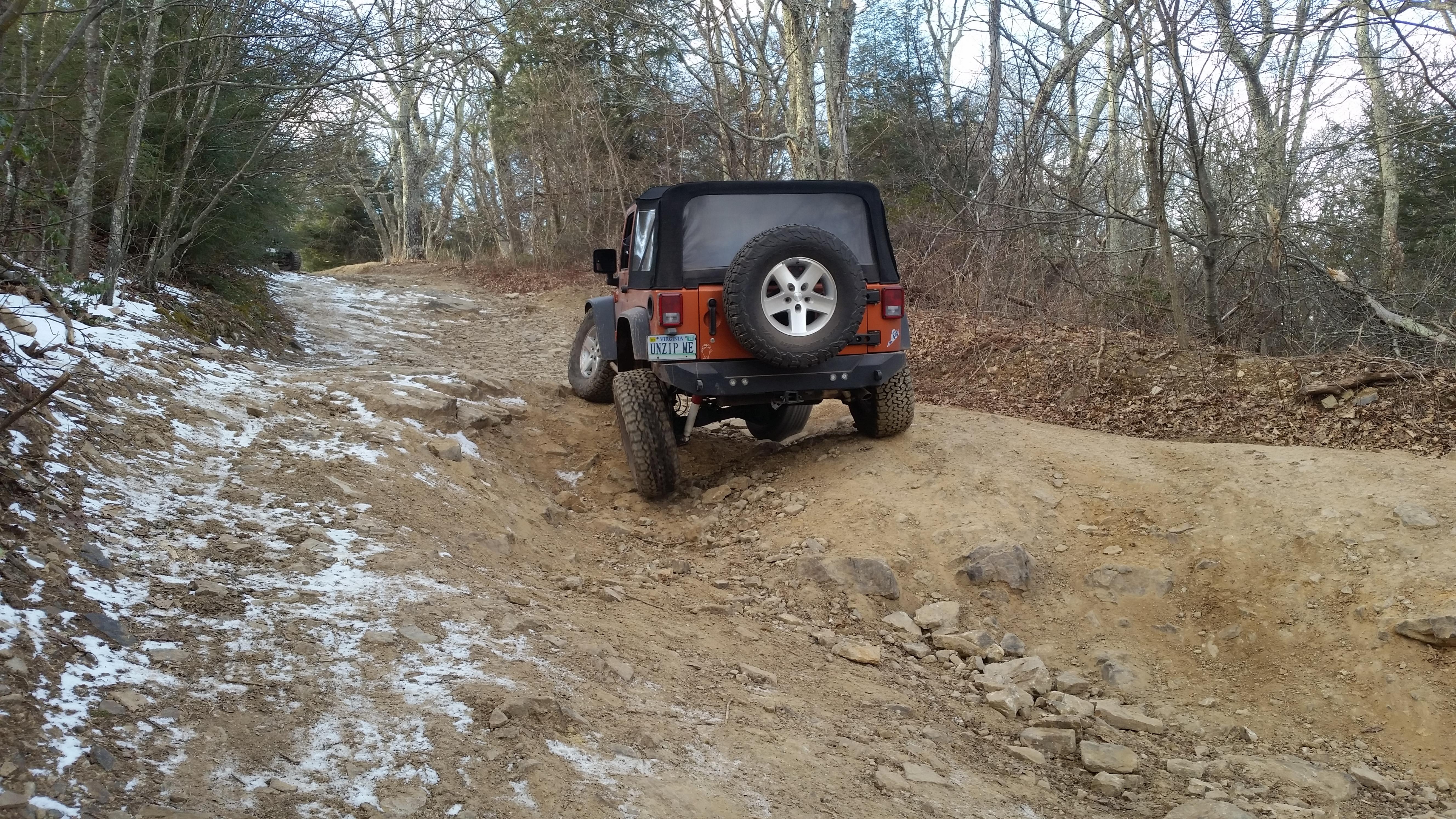

Metalcloak 2.5", 35's, and stock trimmed flares here. I just cut the vertical faces, started out with taking an inch. I maintain the inner liners, structural support, and they don't look as trashy as another set of flares that I cut much closer towards the bend. My cut isn't for everyone, but it's functional without being obnoxious.
First picture is the current cut, second pic is the obnoxious set. Both function the same, I just didn't like the super close cut.

Personal opinion, it's all about maintaining a bit of the curvature up front.....moreso than at where the fender bends over on the side. purely based on looks though and not function. that said, i never see people with trimmed factory fenders saying "they're flopping all over the place!!!!"

No rubbing anywhere and that's without adjusting bumpstops...which should be done but I went with different length shocks with metalcloak relocation brackets front and rear.
