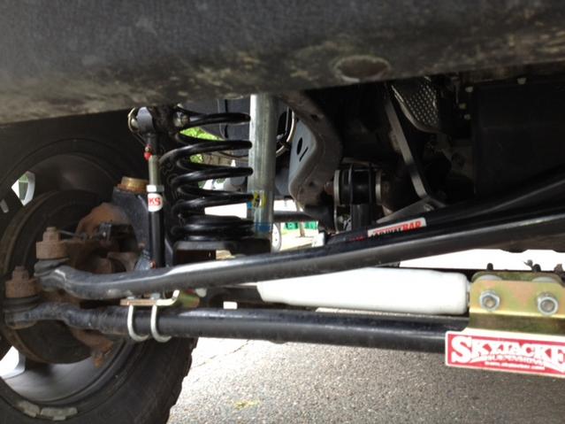

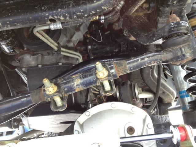

I recently installed a long control arm kit on my 2010 4dr jk , it now has a 5" lift and a 1" body lift. I drove away from the dealer a week ago and at the first stop light ....upon acceleration i feel a slight thud. now a week later (after wheelin on Sunday) I hear a CLANG OR CLANKING sound. I feel its in the front end and steering related? Any info would greatly be appreciated. If ANYONE KNOWS OF A GOOD PASSIONATE ABOUT JEEPS TECH IN THE MA AREA PLEASE LET ME KNOW.
The dent in ur stabilizer is because u didn't flip the steering adjusters up , where in ma are u I got a guy passionate about jeeps at the dealer I'm at he is installing a lift on a 12 jk now

Have you considered a draglink flip kit? Not that it will necessarily solve your problem, but your draglink is at a crazy angle. At 5", I would think at minimum u have a dropped Pittman arm and trackbar relocation bracket but I can tell in the pic.

Have you checked your ball joints? Mine are all done. I'll be changing them this coming weekend. They are clunking pretty bad. The OEM ball joints have plastic bushings. Go figure.

Regarding the clanking, I had a similar issue after I installed my TF adjustable track bar and it turned out to be that the bolt on the axle was a little lose which allowed the axle to move when turning the wheel, causing the noise.
