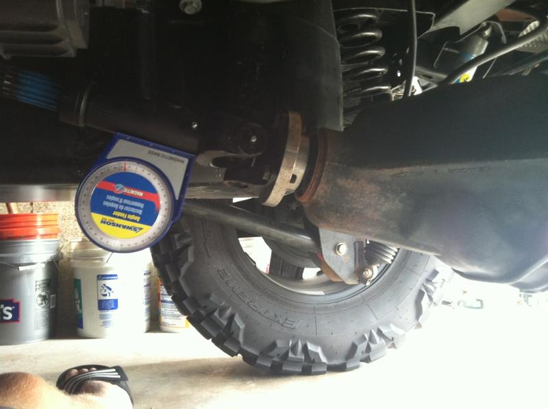

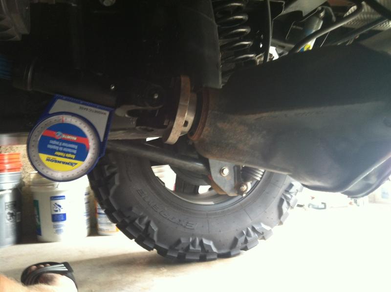

pinion angle with 4 inch lift can anyone tell me if its good with pics
i got a tom woods drive shaft and just did my pinion angle and did -2 down because when you move the rear goes up can anyone with a 4inch lift tell me what they did?

I hope your rear pinion doesn't raise and lower as you speed up or slow down. That tells me that you have something loose. If you had a leaf spring setup that might be the case but with upper and lower control arms you should not have axle wrap.

If your new driveshaft is a double cardan style then the pinion should be about 2° less than the angle of the driveshaft. Since it is the rear and you have no worries about caster for steering just use adjustable contr arms and adjust as needed.
