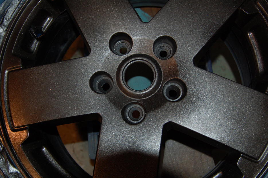

I would recommend painting instead of bed lining. I painted mine dark argent a year ago with duplicolor rattle can wheel paint - still looks great and saved me a bunch of cash!
Glad you asked this question as I was considering bed liner. I don't think i will.
We painted the wheels on my son's Ranger and they look fantastic after a year or so. We cleaned them very well, scuffed them with fine sand paper, primed with self-etching primer and then painted with a few coats of the Duplicolor wheel paint. We are pretty impressed with their durability and looks.

I recently painted mine and crossed bedliner out exactly because of its texture, which will grab all road dirt or worse. Besides, I do not like the rough bedliner's finish anyway.
I used Rustoleum matte black over a layer of primer. It has been holding up quote well.
The first time i painted mine, i sanded it down, then primed it.. let it sit for 24 hours then painted... after painting and letting it sit for another 48 hours i could scrape the paint off with my fingernail
After that i stopped using primer. Just sanded and painted. Done it to two sets of wheels and it hold up great
btw ive found rustoleum semi gloss black to be the best.. ive tried duplicolor and BBQ hi heat spray paint and they didnt seem to adhere as well
