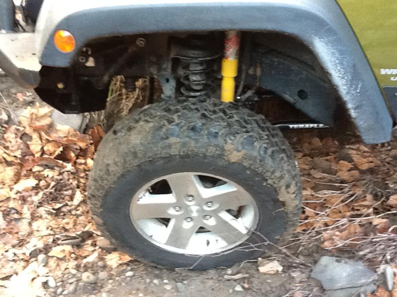

You should be a bit over 3" with those coils?
Both axles are off-center. If it doesn't cause any computer/driveability issues for you, and isn't a visual eyesore, then add trackbar brackets or adj's later.
Both swaybars will be angled down. Depending on the angle and the amount of droop, short links have been known to cause the swaybar to flip around backwards. While the vehicle owner generally isn't too pleased with the outcome, we enjoy seeing the carnage pics. This has also been known to happen on the lift at the shop, so don't think that you are safe because you are a 'light' wheeler. (my opinion, longer rear links are cheap, get them and move the stock rears up front).
The brakelines will be stretched. Flex it and crawl underneath and check them!!! Unhooking and bending the lines may be enough, or spend $10 at the hardware store to make brackets, or go with longer lines. Depends on what you find.
The caster will be lower than stock, causing flightier handling. If you can deal with it, then don't worry about caster correction. If you want to improve the handling, your choices are Cam Bolts, CA Brackets, longer/shorter 'fixed' arms, adj arms. They all have benefits and drawbacks, but a set of adjustables are arguably the better option.
The steering angles will be steeper than stock, possibly causing a bit of bump steer. Shouldn't be an issue at that height, just something to keep in mind.
Rear driveshaft. Should be fine on a 4door.
Front driveshaft. Flex and crawl underneath!!! As the axle flexes, the front driveshaft will move closer to the corner of the tranny pan. Close but not actually contacting, you can rip the boot off. As noted, this is an annoyance, not a huge issue. With actual metal to metal contact, though, you can start caving in the pan or splitting the lip. This will require a narrower driveshaft. (since the front axle is still off-center to the drivers side, you 'should' have plenty of clearance, even disconnected. But check it!)
Also while you are under there, keep an eye on the joint at the tcase end of the shaft. You are looking for grease coming out, and a ring of grease on the undercarriage above the joint. A few people have indicated that this joint can be rebuilt, but I have yet to see it done. (generally, losing that joint means a shiny new driveshaft).
