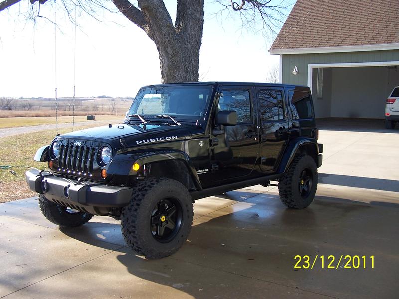

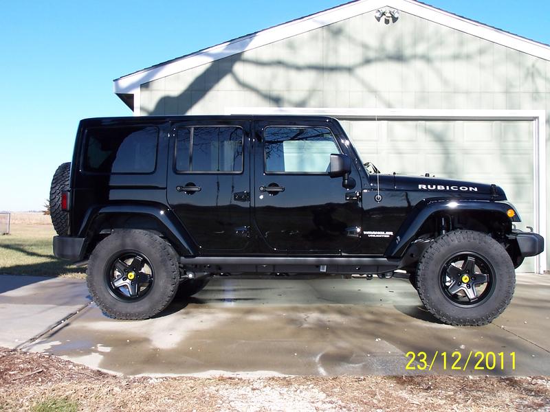

Hey rdubb1031- my rear is 1/2" lower than the front (flares). Here is a pic. I did measure the top of the jeep in the rear and the top of the jeep by the windshield and it seems to be level. Maybe I am not on level ground. Here is a side shot from today.<img src="https://www.jk-forum.com/forums/attachment.php?attachmentid=253650"/><img src="https://www.jk-forum.com/forums/attachment.php?attachmentid=253651"/>

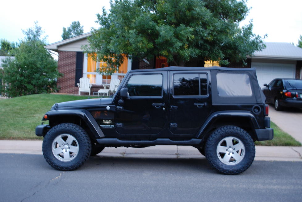

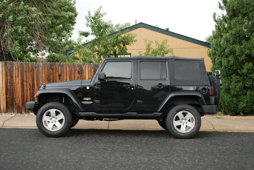

Here are two shots of mine from the side. the first is without the new tires and the second is on a hill sloping down to the left. one thing to note is I do not have a spare on the second. I just went outside and I have similar heights in the wells as you.. may shoot a photo of your spring/link setup and I'll take a look to make sure it matches..

You have a sharp looking Jeep. It makes sense that the flares sit lower in the rear on the body. Maybe due to entry angles etc. I think I am going to put on some shocks, side step/rails, and call it good until I wear out my 33s. Then maybe 35s. Thanks guys!
