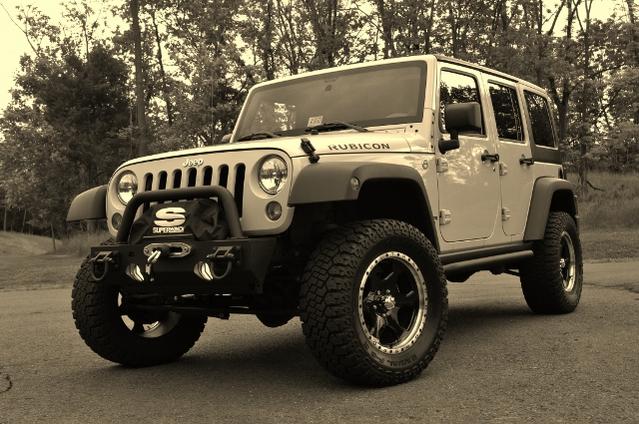

Reason I ask is that I have a '12 JKU auto w 3.73's, AEV 2.5" lift, and 35's. NO complaints whatsoever w the lift or gears. AEV 2.5" lift will allow for heavy bumpers later and not sag. Excellent road manners for a DD.
(Of course my recommendation is based on those criteria. Dont believe the 3.8 engine on the '11's and earlier will perform satisfactorily w those gears).

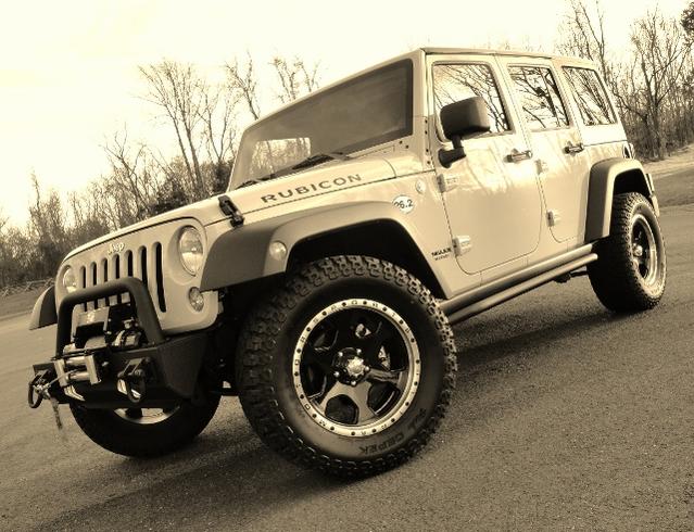

For what it's worth, I recently got around to installing the following:
- Installed Zone 3" Coil Lift kit
- Installed Daystar 3/4" coil spacers on the front (to compensate for bumper and winch)
- Installed JKS Adjustable tracbar and replaced factory 14mm bolts with 9/16"
I'm running this with the stock 4:10 gearing on my automatic and it works okay (minimally acceptable) with the 33" tire setup I picked. Personally I went with the 33s because they fit my DD and occasional wheeling needs. Also, I did not need to calibrate my speedometer. Overall the lift really made a difference in the stance and ride, and I'm very happy with the results. I've included a before (left) and after (right) photo to show the height difference.
