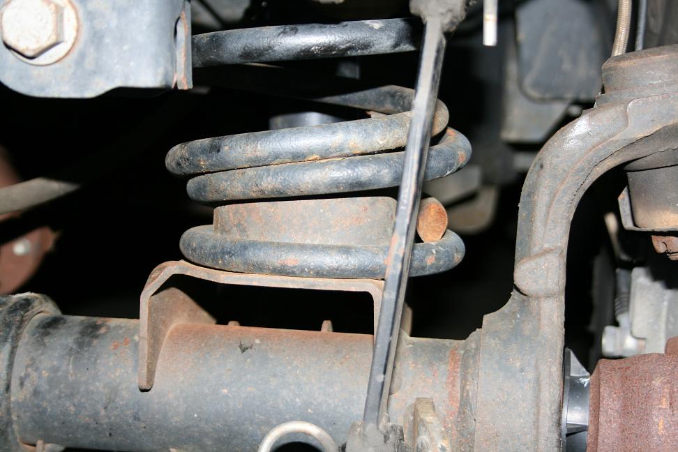

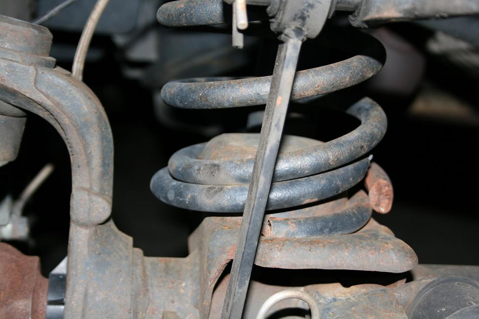

All is great, right? Well, they pointed something else out to me. Apparently, I have broken BOTH of the front coils from my Teraflex 3" lift. Anyone ever heard of this happening? The most I've ever wheeled is driving on the beach or a trail (on account of 3.21 gears and no lockers). I just don't see how this could have happened. It must be about a year old because there is rust and the Jeep has been in storage a while. Drives fine, but darnit, I am just so disappointed. Anyway, if this is endemic of Teraflex, well, maybe I need to upgrade to another brand, but I am new at this and could use any info.

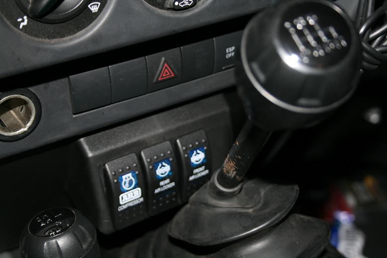

On another note... I got the Daystar panel for the ARB switches, and it has interference from the rubber boot around the shifter. When moving from neutral to first it will actually turn off the front locker. Is there a different boot I can buy? Or a work around? It works somewhat if I push the boot as low as it can go, but that just seems kind of... nasty.

try to move the boot down on the shifter and use a hose clamp or something to keep it there. The daystar panel is a pos when it comes to installing in a manual. I emailed them about it, thats what they wanted me to do, pretty piss poor design if you ask me! Luckily i only installed one switch, any more would not work (like you are finding)

wow, thats some weird stuff. springs are pretty damn tuff, i just cant see BOTH of them snapping like that. I kinda wonder if someone cut them trying to steal them. i dont have any TF parts, but have heard nothing but good about them. talk with them and see what they can do for you.
