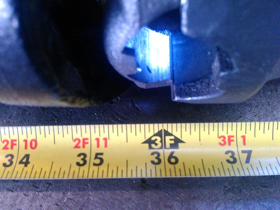

hi guys, I am rebuilding a front driveshaft for my jk, and I would need measurements to make sure I cut it the right lenght.
2012+, auto trans. 4-5" of lift. Front OEM flange to transfer case yoke, measured at the center of the joint. see pics
I took measurements on my friends 07 jk with the 42RLE and he have 35 5/8", Jeep sitting on its wheels, it has around 1" of the slip yoke showing. but what about the 3.6 with the NAG1 transmission?

mine is a 14 rubicon auto and I have a Dana Spicer aftermarket ds and 36" from flange to center of yoke with 1.5" showing at slip joint on ground. ~3" lift. Dana Spicer lists it for 2-4" lift.

The way I understand things, I could still cut it one more inch, and it would never matter.
